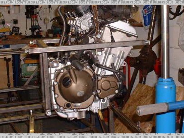

Ive just done my R1 out of 1", the ST cradle is actually 2" x 1" but I think thats overkill really. It also depends on if you are going
to support the entire engine from the cradle, or have seperate mounts for the lower mounts etc.
Here's my R1 cradle we did at the weekend, using the pickups I welded on for the ST blade cradle.
  R1 Engine Cradle
  R1 Engine Cradle Front
Chris

I see you have additional engine mountings on the cylinder head is this necessary with all the normal mounts on a R1?

ChrisGamlin
| posted on 1/4/05 at 03:58 PM |
quote: Originally posted by Minicooper
Chris,
Ive only used the standard mounts, there's 4 on the head / upper block on the R1 (on my 2003 engine anyway). The way the rails ran across it
seemed silly not to pick the cradle up off all 4 bolts around the head area to give it a bit more strength, the thnking was that unless it twisted the
cradle or the head itself, the engine couldnt go anywhere even if the gearbox mount failed for some reason. It also makes it easier to lift out
without having the gearbox mount on the cradle like the ST blade one had.
If you're putting a lower cradle/mount in as well you probably wouldnt need to pick up on all four of these though, just the upper block ones.
Ive not currently got a lower engine mount, I might add a simple one just to be safe although my ST cradle for the blade didnt and that was fine.
Chris
[Edited on 1/4/05 by ChrisGamlin]

My 2001 R1 hasn't got the triangular mount shown in your picture, I have 3 on the head and also use bothe the top and bottom gearbox mounts
