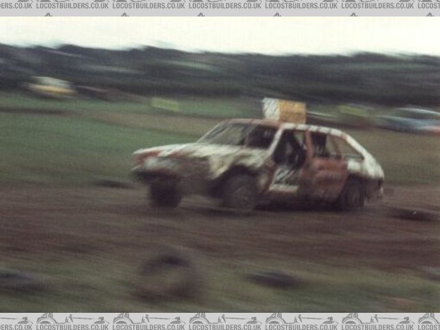

Homer
| posted on 6/1/03 at 06:47 PM |
Hey Jon which club did you race with? Ever come down near the south coast to race? I might have been there to (Weymouth club) What car did you
drive?
Jon Ison
| posted on 6/1/03 at 07:12 PM |
Class 8, 9, & 10, spent 15 years at in total, but as you well know, the cost of running a special is now more than club circuit racing ?????
the drive looks better without the mud all over it too, oh Nottingham club, raced under N8, then N2........
i still do a bit of banger racing from time to time, last car a cav came out in profit, £20 for car, one final win, £50, £30 profit, never heard of in
grassin ????
