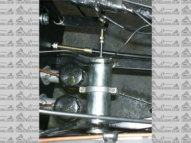

I have fitted to mine, whilst changing up with it is fine as long as you either have the ignition interupt fitted or blip the throttle. i just cant
get it to change down.
maybe a setup thing i dont know.

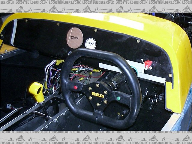

Brooky
| posted on 19/7/05 at 11:00 PM |
the buttons on that whell will probably fail sva, but i got some buttons off the klicktronic chaps ( very helpful peeps actually really should talk to
them about setting up the down shift ) which passed sva no probs.
I have a gear lever and tend to use that more than the klickythingy. If i had the opprtunity again i would go for a finger tip lever system.
