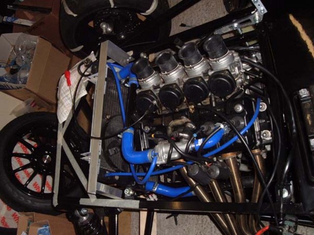

The Engine Bay with all the Hosing and currently Hiding all the wiring
![](/galpreviews/samco engine Bay.jpg) ![Description](/gallery/samco engine Bay.jpg) Description

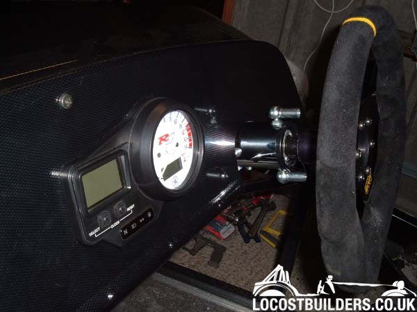

Carbon fibre dash Indiglo R1 Dials and wiat for it.... the mirror finished paddle clamp with quick release steering wheel ta OX!

Just wondering if you have any close up pictures of the paddle shift mechanism being put together?
How does the clamp attach to the steering column? And the pivot points to the paddle?

Chris you need 6 rose joints
1 goes off the gear lever then some 8mm threaded bar goes to another rose joint, which is the one at the bottom of of the lever.(This is a rear brake
lever of an aprilia rs250) with the braket/bush so it moves up and down like a see saw which is where its bolted to the engine cradle bolt.
then the rose joint on the other side of the lever the top left one a bar goes from here through the dash(you can now push pull this to change
gear!)
you make a paddle shift out of alloy which bolts to the two rose joints on the steering wheel clamp this can then paddle from side to side, then you
connect your bar coming through the dash to an L bracket on the back of the paddle usinga rose joint and hey presto one gear change
