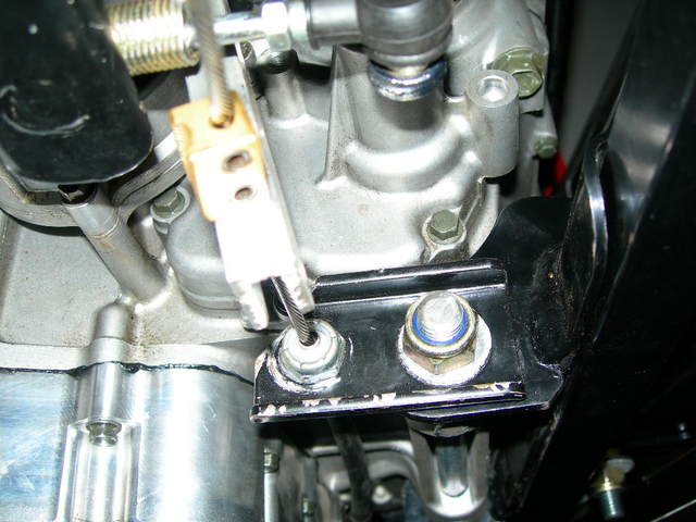

I have a busa engine and just decided to use a gsxr 1000 clutch cable. I worried that there just wasn't enough space for the slave cylinder near
the shaft

how did you make that work? did you take the gisxr 1k clutch actuator out of the sprocket cover and make a new bracket for it? i know it couldnt stay
in the sprocket cover, it covers up the sprocket so no driveshaft. or did you just cut out for the driveshaft?

Yeah. that's what I did. took off the sprocket cover and fabed a lever to mount in the existing sprocket cover holes. Enough said, a picture is
worth more that a 1000 words.
Here are pics I got from Jim Gould in Canada:

clutch push rod will need to shorten no more than a 1/2 inch. Moreover, the pushrod length depends on how far the bracket/lever extents out from the
engine. In the picture the bracket extents out enough to not interfere with the prop-shaft sprocket adapter. Fab the bracket- lever and test the
range of motion before making a cut to the pushrod.
But for the gxr 1000, setup will be different since it is natively a cable- based clutch actuator
