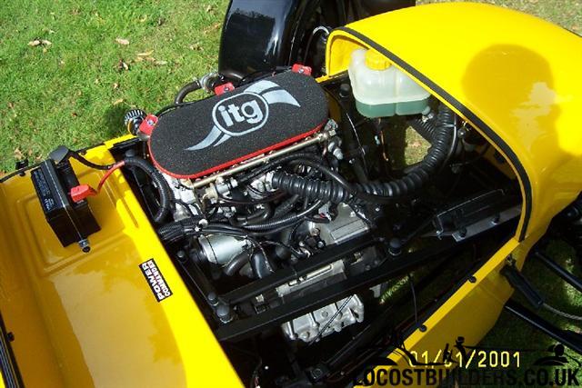

I had the 929 rry engine fitted in my last MK Indy great engine,bullet proof,no sump mods required,power wise,not far off the r1's,just make sure you have the ecu and matching key,honda's hiss system,without them you will not get it running.
You will also need a power commander to help get it though sva,and help to get the best out of the engine,I also had a itg foam filter fitted to mine.
There's a video of mine at cadwell park on Hellfires webb site to give you some idea of what you can expect when your up and running,theres also a few pictures in my archive,anything else I can help you with let me know,good luck with the build.

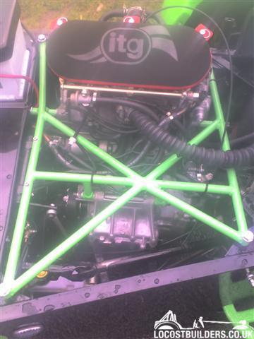

PAUL FISHER
posted on 9/8/07 at 09:36 PM Reply With Quote
The engine frame was made by MK,part of the kit,but they will make you one up,they have a 929 rry fitted to one of there demo cars now,the new spec-r chassis,here's a picture of it fitted in the chassis.

PAUL FISHER
posted on 20/2/08 at 12:08 PM Reply With Quote
Bought the filter from merlin motorsport,supplied with a blank base plate,just had to cut the holes for the throttle bodys,it was around £100
Mounting the engine,you don't want your sump sticking out more than 20mm to 30mm maximum below your bottom chassis rail,to ensure you don't have ground clearance problems,and as usual try to keep the gearbox output to prop angle as straight as possible,no more than 7 degree angle max,prop uj's wear out rapidly above this angle,so the straighter this angle the better,if you keep to that height and angle the engine should be in its best position for your instalation.
