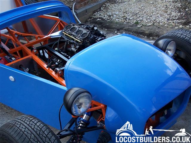

posted on 6/12/07 at 05:29 PM Reply With Quote
and this

Do you have a pic of the other (ie passenger) side of the throttle bodies at all as i think thats going to be my problem area to be honest??
The issue i have with the Tiger is that the lower chassis rail to the front edge of the scuttle is only 605mm according to all my measurements - and the bonnet slopes down by an inch or so from there giving a good few mm less than 600mm clearance where the engine will sit. I will be spraying my bonnet so think i could fit a small bulge if the servo motor fouls the bonnet - maybe over-concerned on this now but after all the delays of trying to get the 05 R1 in I really want to get this right.

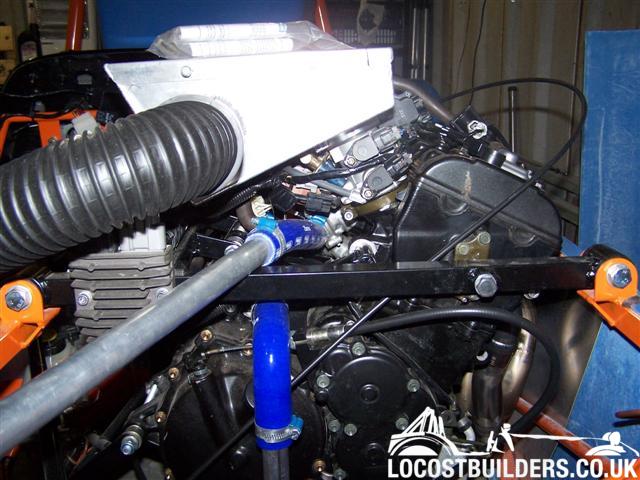

this is the only one i can find at the moment but wil keep looking

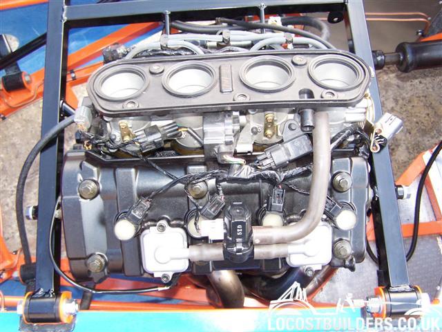

posted on 6/12/07 at 06:03 PM Reply With Quote
does this view help, the servo is only as high as the air valve solenoid
Ah thats great thanks Rich. I take it the highest point on the engine is what looks like a servo motor betwen cylinders 2 & 3?? At least i can get a filter on there which was impossible to do with the R1
That shows it pretty well. I'm sure i can figure it out looking at that - think i will get the scuttle and bonnet from Tiger as soon as possible - they offered to supply me with slighly damaged panels (generally bits of gelcoat missing resulting from being stuck to the mould) at pretty cheap prices seeing as i will be spraying them myself.
