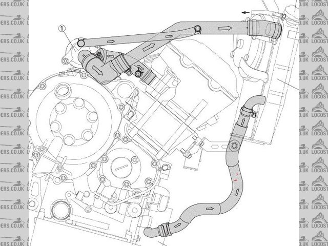

I'm trying ot plumb in my 2005 R1 motor using my Polo rad. I can't work out where to plumb the outlet from the oil cooler. It appears to go
into a point near the bottom of the radiator. As I'm using a Polo radiator, the outlet form the oil cooler has to go into the top or bottom hose.
Any thoughts?
Here's a diagram from the Yamaha manual.
Wyn

adithorp
| posted on 7/1/08 at 11:04 PM |
From memory (and that diagram) on the bike, water goes from the oil cooler outlet into the rad inlet side, through rad and back to the engine (cooled)
via the bottom hose. So (and I don't like to disagree with Malc) it should go into the top hose on a Polo rad and return (cooled ) through the
bottom hose.
There's a flow diagram in the R1 manual as well as the one you've shown.
adrian
[Edited on 7/1/08 by adithorp]

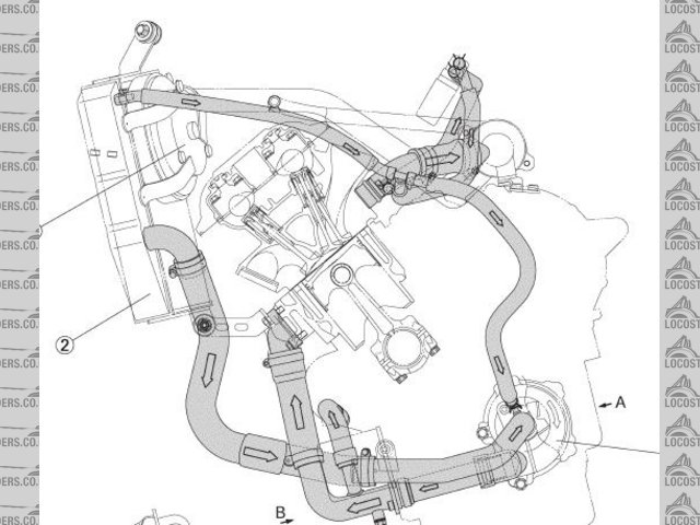

lsdweb
| posted on 8/1/08 at 08:19 AM |
It doesn't go in either the top or bottom hose on the bike. the attached picture shows that it goes into the rad at the same level, but the
opposite side from the bottom hose / outlet to the pump. So it does get some cooling through the rad.
lsdweb
| posted on 8/1/08 at 08:21 AM |
And here's the bottom hose exiting the rad.
adithorp
| posted on 8/1/08 at 01:06 PM |
...which is the inlet side of the rad...as I thought/said. ;-)
