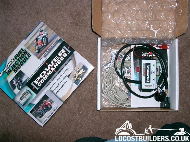

hi i have a brand new power commander type r with full race muzzy map and are a bit rarer than new type as it lets you do the advance and retard £190 to fit 2000 up to 2002
