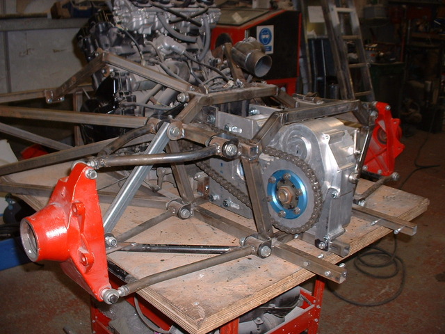

lsdweb
| posted on 31/1/08 at 09:51 PM |
Chain drive in my mid engined set up.
KevDo
| posted on 31/1/08 at 10:14 PM |
wow! loving the twin engined buggy there!..
The chain drive one looks like good work!! any advantages of using the chain/sprocket on the shaft over using a car diff? i assume there will be
bigger loses using the diff over the chain.

lsdweb
| posted on 1/2/08 at 07:29 AM |
Variable ratios, simplicity, light weight. Plus the orientation of the engine makes a chain the most obvious option.
It still uses a car diff though! That's a Quaife Fiesta diff in mine.
