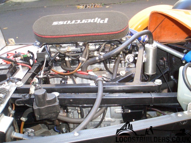

What sort of fuel pressure does a 5pw injected r1 run at.
Can i use 8mm copper tube for fuel lines with fuel pipe held on with jubilee clips at either end or is the pressure too great?
ruskino80
posted on 21/3/08 at 08:13 PM Reply With Quote
thats what was used on mine however at holeshot for dyno set up they said would have been better with 10 mm.can be seen in pic.
2 years on and no probs though.
[img]http://[/img]

Should be fine then
Many thanks
Craig
stuart_g
posted on 21/3/08 at 11:29 PM Reply With Quote
Best off using proper fuel hose clips rather than jubilee as they don't grip the pipe all the way round. Some SVA centres may pull you up on it.
