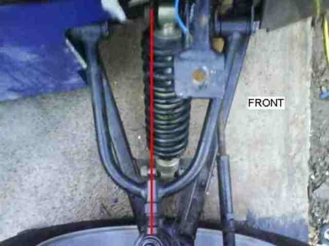

After at Newark noticing the front top suspension arms fitted to the wrong sides on a certain members indy having heard him complaining for probably 2 years of the problem your describing I would check that first.
The offset of the top and bottom ball joints should be slopping to the rear of the car!
He now reports it to drive like a different car

Yes I agree with locoR1 top wishbones on the wrong way round gives the feeling you discribe,so check that first,on a smooth road,you should be able to take both hands off the wheel at 120mph they are that stable at speed.

asl
posted on 29/6/08 at 05:37 PM Reply With Quote
I've taken a picture of the right front. What do you guys think, right way round? To help orientate the front of the car is to the right as you look at it. Thanks for your help
[Edited on 29/6/08 by asl] Rescued attachment IMG_0737.JPG
locoR1
posted on 29/6/08 at 05:42 PM Reply With Quote
That looks right to me so much for that theory
Kev99
That looks right to me its how mine is now
[Edited on 29-6-08 by Kev99]

Kev99
posted on 29/6/08 at 05:46 PM Reply With Quote
