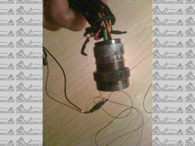

Anyone know how you get the inside part of a military-type connector out so you can re-wire it!?
This is a Souriau one that came with my Stack Dash (used). It was wired for whizzy track-stuff, but was missing leads for a few things I wanted.
There was a fair bit of glue inside the rubber sleeve that covered the wires, so it may just be a bit sticky still. That said, I don't want to start yanking at bits if I'm yanking the wrong part!
Any advice gratefully received!

Yes, the back unscrews but its a left handed thread.

Ah a Plessey plug! We had a special tool that you placed on the wire and pushed inside the socket to release it from the plug. Just a long thin tube thing.

It could be crimped or soldered terminations
So would need to check part number, if you put it up here I can check at work for you.
If its a crimp terminal you need a proper removal insertion removal tool to remove the pin (from the back or the front depending on type)
If its a solder type: the rear on the plug was probably filled with rtv/silcon type stuff, as need to unscrew the back shell then remove all this stuff, then can re solder new wires to the pins
But need to confirm which type it is before going any further.

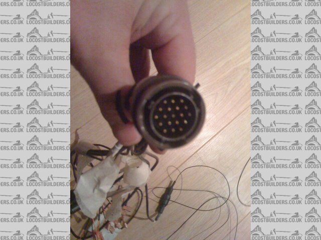

From the photo I'd say the inner does not come out. Conductors are terminated by crimping on the pins / sockets and then inserted into the plug using an insertion tool, (basically a thin walled split plastic tube), there is also a dedicated extraction tool both dependant on pin size.
See here for a selection http://www.astrotool.com/catalog/insertion_and_removal_tool_illustrations.html
Anyone in the aircraft industry should be able to get you one of the ones shown centre at the bottom, (they are disposable).
Regards Mick

Deffo doesn't come apart, so the wires must be inserted in situ, or the pins must come out individually.
Can anyone recommend a suitable tool?

Looks very much like the one I broke trying to get it apart, then I could see that, as makeeverything said, It was a left handed thread, kind of tight and awkward to unscrew.
I'll go see if the remainder is still kicking about in the garage for a pic.

You will also find it very difficult/ impossible to get the contacts out with out removing that back shell section first, because the rubber section clamps the wires to prevent movement.
Best way to do this is to connect the plug to hold the front section steady, then use 2 sets of cannon plug pliers to hold 1 end steady, and the other to get the back shell undone.
you can just use similar pliers but with foam tape (so not to damage the plug)
Any questions just ask.
