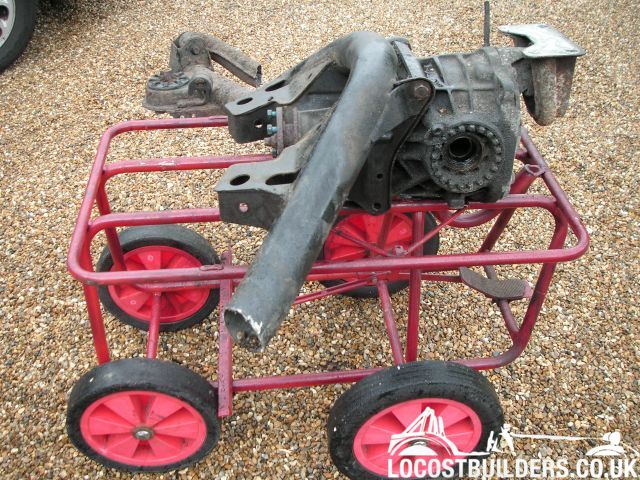

easiest way I've found is to take the whole rear beam (sub-frame) off
use saftey goggles when your underneath - or you will get lumps of rust in you eyes
as for tools make sure you take your socket set inc 15mm (preferably with single hex sockets and a long lever/power bar), spanners, hammers, hacksaw,
releasing oil, levers, bolt cutters (I've probably forgotten something, but I'm sure someone here will add to this...)
you could use an angry grinder for some of this, but remember your right next to the fuel tank
jack it up as high as you can and properly secure it with axle stands or similar (I used a big pile of old sleepers) - just be really, really
sure that it can't squash you as your going to be underneath and will need to use a bit of effort to get some of the bolts loose....
and bear in mind the chassis might not be that solid in places.... (one of my jacks disapeared through the sill on one of mine - the car dropped
8" in less than a second )
take the wheels off so you can get acsess behind them
then disconnect the prop shaft (either at the diff or remove the centre bearing clamps & rubber dounut bolts)
if you take it off at the diff flange - save the bolts! (they are M10x1.0 - very fine pitch and hard to get hold of )
disconnect the dampers, brake lines, handbrake cables, ABS sensor wires and any other bits and bobs that are connected to the chassis (I used bolt
cutters and a hacksaw for most of this )
then its best to best to stick the jack under the diff to take its weight
then remove the two rear beam mounting bolts (one each side at the front, they go through a big rubber bush) - these 'will' be tight
you might want to put the wheels back on at this stage (so the they take the shock of the landing), but could be easier just to put something
underneath the hubs for them to land on (old tyre or similar) this way you won't loose access
then remove the diff rear mount (I found it easiest to take out the 4 bolts that hold it to the chassis) - make sure you not underneath the rear beam/
diff when you do this - just incase your one does just drop out easily (unlikly but you neve know)
it should now be sitting on the jack, so in theory if you lower the jack it'll drop down slowly - in reality the rubber bushes on the front
mounts will probably not want to let go
if you let the back drop too far it'll twist on the mounts and make it even worse, so I'd drop it 2 - 3 inches then 'presuade'
the front ones a bit (I use a 6ft lever)
and you should end up with this:
mind you that was the second one I did and I cheated
then you can remove the driveshafts / hubs at your leasure - if it has bolt on shafts then you'll need a T40 torx bit (actually you'll
probably need 2 or 3, they are a nighmare) clean them as best you can and soak them in releasing oil before you try and take them out
