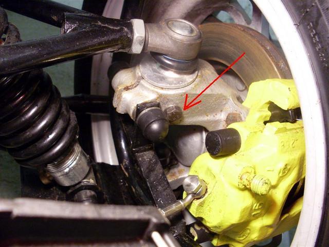

renetom
posted on 18/3/13 at 07:54 AM |
Hi
Off centre ones
Good idea to fix them also
easy to do just drill & tap + bolt
loctited in.
I like belt & braces.

I have mine marked to I can place them back in the same place every time. But not tapped as yet
On the new type is the camber adjustment still the same as the original ( the arm is threaded so minimum adjustment is 1 full turn of the top ball
joint) or is it a rotating sleeve for finer adjustment ?
Ryan
