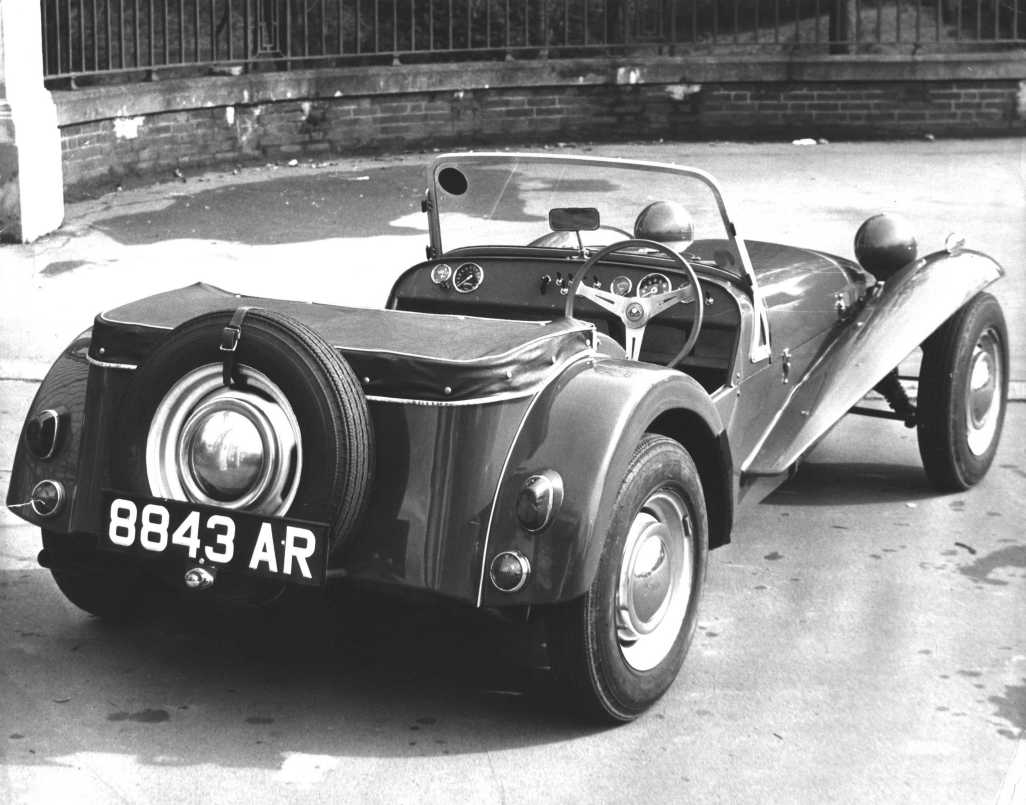

rightly say Sierra donors are available. However I'm aiming for the build to be like a freshly built classic car - something akin to this:
...al be it if I could have a modern equivalent of a Lotus Twink that kicked out a reliable 150+ bhp I think I might be able to shock a few people. A
classic recipe and looks, coupled with a little more power than expected could make a truly wonderful little machine.
