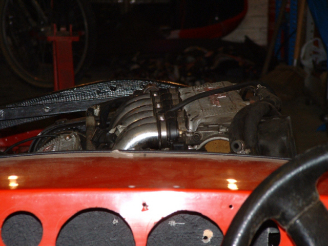

Just got the engine out of the donor, and offered her up to the chassis.
She looks as tho she may well fit !
just need to adapt a type 9 to fit and away we go.
complete car = £150
BHP in standard form = 200
number of cylinders = 6
clearence between chassis rails and engine = just

Do you all think I should try to fit it, or go for something smaller.
Its not too heavy !!!!! i think about 165kg. Alloy block and heads.
Its very pretty, and a bit different

My only real concern would be height - are you going to need a bonnet bulge? A very big bulge?

Trev Borg
posted on 13/11/04 at 11:10 PM Reply With Quote
I don't think the height of the engine is going to be too much of a problem.
The engine is going to sit half an inch lower, the body is just resting on he chassis and will sit an inch higher.
In the Alfa the plenum sits on the higher head due to the slope of the bonnet, but it may be possible to re-site it to the lower head, so making the engine shorter.
If all else fails and i end up with a small bit sticking out, I already have a matching gelcoat bonnet bulge.
I must agree about the alfa 6, not a snowball in hells chance of finding one in the UK.

600x450. Saves space and loading time and you can see what's in the picture without scrolling across 3 screens on a 17" monitor. How do you get the steering column past it?

posted on 14/11/04 at 11:26 PM Reply With Quote
past the engine or the huge picture ?
The steering is clear of the engine.
Because its a 'V' it aint that wide low down. Runs a little close to the filter, but I'm sure I could find a smaller one
By the way, My friend 'Welly' is in the process of making a bellhousing for the alfa to mate a type 9, but we need a ford clutch plate thats 230mm. Any Ideas which would do ?
