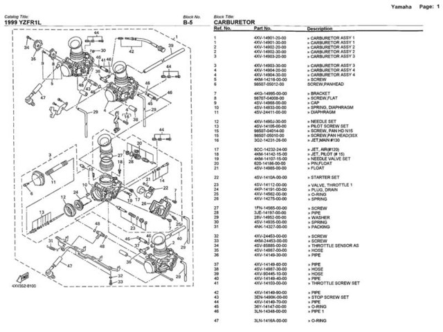

mad-butcher
posted on 13/1/08 at 11:33 PM |
hope this helps
