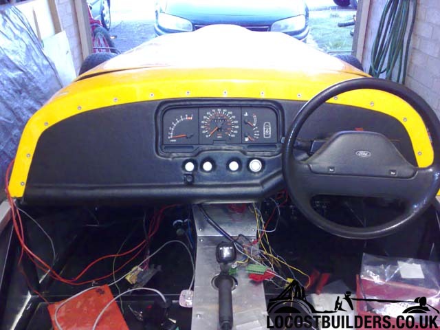

Maybe this'll convince you

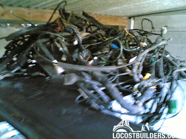

You should then end up with a pile vaguely resembling this (from a Granada)

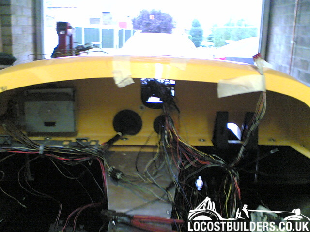

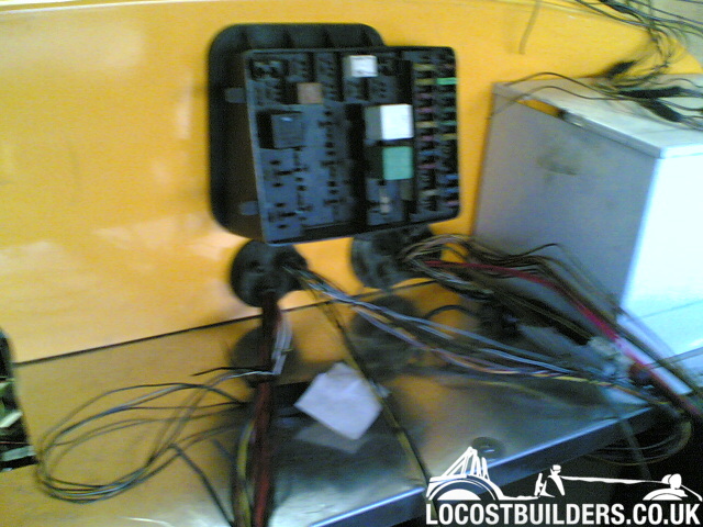

which you should be able to thin down to eventually look like this in the car
and this

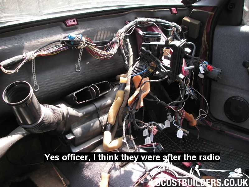

and the dash might look like
