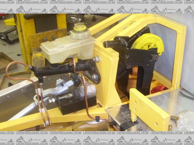

Schrodinger
| posted on 15/6/08 at 08:12 AM |
Mark
I can't see any reinforcing from the top of the plate to the chassis, if you have none you will be surprised at the flex when you hit the brakes
and that will be a SVA fail (guess how I know)
Keith

Mark Allanson
| posted on 15/6/08 at 02:41 PM |
Ahaa... just trying to catch you out, this is finished but without the covers
