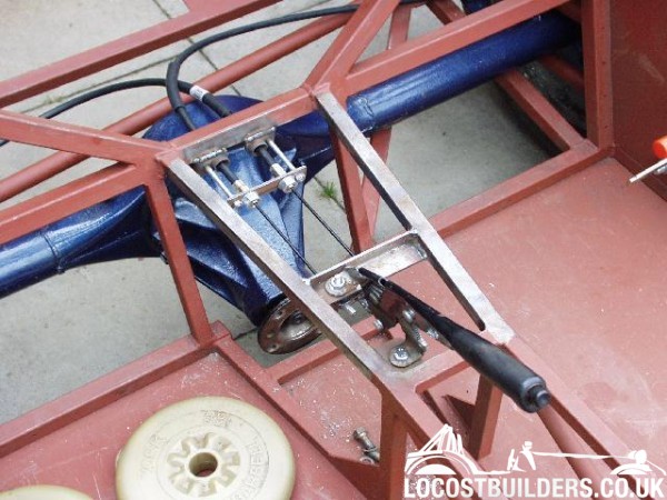

What handbrake cable would people reccomend. I have a metro handbrake lever but the cable is too long - any reccomendations.

We used Allegro as per the book, they're ideal.

Depends on what rear set-up you're using.
On mine (discs at the back / IRS) I used two Sierra 4*4 cables cut down so I had an adjustable screw thingy on both halves... then some cable clamps on the chopped inners.
Not the cheapest but works well....

I'm using standard escort drums. Will the allegro ones fit my metro handbrake lever?

use 2 allegro cables your metro lever will be fine do it somthing like this (not sure who this car is but i borrowed it ages ago so i knew what to do it like regards and thanks to whom it belongs) edit - remembered it is DavidM car i think he has more in arcive hope you dont mind me showing ya pics david

Mines done almost the same as the picture (although its not my picture)
I have made a balance bar so i can adjust free play in cable if required as the Alegro cable has no built in adjustment.
chris
No problem Chris, help yourself.
