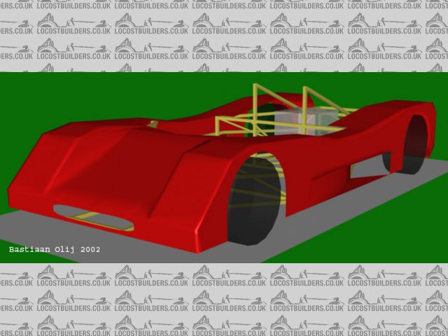

I am not happy with it yet but this is the basic idea for the body work....
It's hard to get the shape right in 3D, probably when I need to make the real molds I can get it much nicer. Awell we are far from that stage
yet:-)

Hi again Bas....
I agree about curvy shapes being hard to do in 3d....
What software are you using?
Looks like you are on the right track so far.
HI Alan,
Using 3DS Max for this so it is pure modeling, no calcs whatsover for the structure. Did some final tweaks and I am pretty happy with the end result.
Only needs a nice spoiler. Also I couldn't get the doors completely right, I'll have to figure that one out when building it.
The Limbo doors are just for fun, I have no idea yet what mechanism I am going to put in place for the doors.
Gonne continue now on finishing the space frame and the on to suspention and all that.

Anyways, I wasn't to happy with the body, it just didn't look right, so I've been looking at the pictures of similar car and desided to redo the body.
Some small changes to the frame and a new body. Not finished yet but looking alot better then before!
Damn, keep putting 2002 in the pictures:-)
This is one where you can see the altered frame design (and yes, I haven't done some of the things yet I was going to put in:-))
Very nice work, but don't forget to drill holes in the floor to get rid of the rain now you lost the roof...

Hey Bart,
Looking good! I wonder though, how are you going to place the air ducts? Seems there are some bars in the way? Could be wrong though, hard to see
without the body
I designed on top of the model drawings I've send you earlier, and used them as a background. Therfor airducts should be ok. The sidepots are made smaller , so the actual bodywork will/would have some air in between there. So some place for airducts. Only the lower left one will slightly interfear with the sidepot-bar. So a small cut-out and a painted frame would hide that. That was the most challenging part by the way, making sure I could use all the airducts... A scale model will show if my calculations are ok...
Oops, turned out I made a critical design error, if I had build everything like this I would not have fit in the car:-)
BIG oops. Just made everything to low. Also the radius of my tires was a little to low. Adjusted everything so a 17" and maybe even an 18" is
possible. So far still basing everything on the 16" that comes with the RX7. Tire size is currently 205 wide, design should allow up to 250 to be used
perfectly.
I've adjusted almost everything to more realistic messurements. As a result the car is now 1m70 wide and 3m50 long, ground clearence is still 10cm.
The highest body point for the 'cabrio' is 65cm (75 above ground). With the top on the highest point will be just over 100cm (110 above ground).
Haven't adjusted everything so there are still some things missing and some faults.
