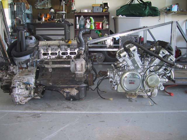

sgraber
| posted on 22/11/03 at 03:00 PM |
Some of you may not know that I actually had a VMax/Venture engine in my garage to be installed mid-engine into my car in place of the 4AGE, but I
just couldn't convince myself to use a reverse running differential... Just picture how the gears in a differential mesh together. Then think
about the loading on the gears in reverse. Not pretty. I simply can't imagine it would last very long So I scrapped the idea.
However --- I truly want that unbelievable trike to succeed! and I would LOVE to hear updates on the FWD VMAX project as it makes it onto the road!
Specifically related to how scary it is and how the diff holds up!
Graber
Steve Graber
http://www.grabercars.com/
"Quickness through lightness"

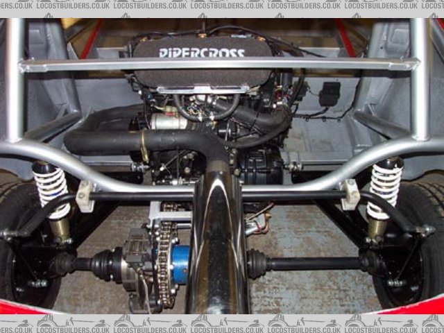

MikeR
| posted on 2/12/03 at 12:10 AM |
Had a brain wave .....
BMW bike engines are shaft driven to the rear (well some are before someone tells me model x isn't). Now this is going to mean a little offset
to the diff but at most we're looking at the width of the rear tyre plus a little.
So back to the original idea of bike engine and car diff - except the engine doesn't have to be really offset to the left!

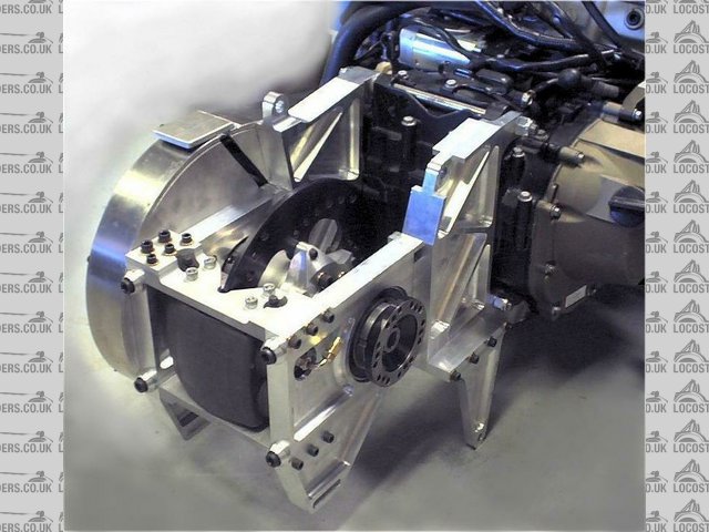

Rorty
| posted on 8/12/03 at 05:51 AM |
Try a search of this forum, as I think I described a method of doing what you're talking about a while ago. Basically, a Golf diff is the one you
want, as they come with flanges and CV joints, and there are a huge variety of stock shaft lengths to chose from. All that's required is a
fabricated/spun cover for the diff with a couple of O-rings and a bung/plug for the oil.
Here's a pic of something more expensive.
