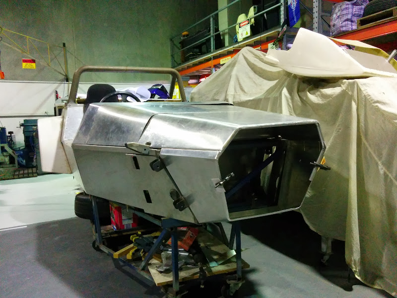

Having smacked the front edge into some semblance of a consistent curve I arrive at this:
After some trimming to make clearance reliefs and more hammer/dolly work around their edges, it looks like this:
Too hot in the workshop today so didn't get much more done. Need to do some more fiddling with the bottom half of the forming buck so
it's ready for the next stage.

Marked out the pattern for the bottom half of the nosecone using the wooden buck:
Cut the resulting "bowtie" shape out of 1.2mm ali and started rolling the corners:
The corner radii are too small for the forming rolls so I had to use classic methods - pipe, clamp, and brute force
Only got as far as folding the rear flanges tonight - next visit, I'll finish the top flanges (where it'll join to the top half of the
nose) and roll the front edge over:
(Second night):
Offered the part up to the chassis and trimmed somewhat where the radiator support interfered with the bottom edge/face:
Trimmed things at the top a bit so I could drop the top half of the nosecone in place (with the edges just overlapping for now):
Yes, it is a bit "wide mouthed frog" There's going to need to be some attention to that aspect of it - it will look somewhat
smaller once the edges are rolled in and a it's in body colour with a black grille etc.
Took an overall shot as well to get a sense of how it's all coming together:
I'm pretty pleased with how it's looking but maybe it's a face only a mother could love

Marked the bonnet to size and formed the bottom edges (this picture was before I'd done the left side which is why it's sagging):
Remade the bottom half of the nosecone and got it (temporarily) joined to the top half for fitting. Still needs its front edge rolled over but I need
to modify my forming buck a little for it to fit.

Got a bit done tonight. Having trimmed the wooden buck down enough (just) I squeezed the bottom half of the nosecone over it, marked, removed,
trimmed, re-fitted, and then hammered the edge over. Having done that, I could turn to my "What's an easy way of reinforcing this edge
and making sure it's got a nice profile" solution a.k.a. a length of 16mm ali tube Some pie-cuts in the corners (which will get a
visit from Mr TIG) and Robert's your mother's brother.
Need to get another bit of tube because I only grabbed enough to try the idea and was a little surprised how well it went so only got this far
tonight:
Don't worry - there's a mitigation process in the planning as well to address the Whale Shark (©, ®, and TM) look of the front
More on Thursday night (probably).

The anti-Whale Shark work has begun This is just mocked up in card here although I have started on the ali piece. Stuck a wheel on to get some
sense of proportion too.
Profile looks alright to me as well....

Today I made a hammer form and knocked out a proper cross rail for the nosecone:
After some trimming, that was rough fitted:

Hinged the nosecone off the bottom front of the chassis:
Which of course then makes it clear that I hadn't thought through the pivot radius etc viz-a-viz the notches that clear the headlight mounts
Some judicious trimming has made the notches bigger and I can pretend it was designed that way This shot shows the trimmed notches and the reason
for tilting the nosecone....
Yep, the whole lot will tilt as an assembly.
