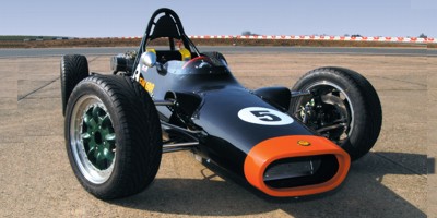

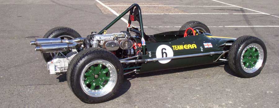

I've got a "lightly" blown up SVT focus (ST170) engine lying about (bad cambelt failure -- 8 broken exhaust valves couple of dinged
pistons and a smashed exhaust valve seat) -- I've started eyeballing it as a starting point for a Tiger ERA inspired single seater (this engine
is probably beyond economic redemption but suitable for mocking up -- it's a decent engine in the focus but i imagine it would sparkle in a
1,000lb-ish car).
The Passat 1.8t gearbox has been mentioned in other threads, I'm not sure if it would look as pretty as the Hewland but it definitely fits the
budget better.
Bodywork looks simple enough, perhaps a glass nosecone/ring and a few sheets of aluminum formed and riveted, locost-like chassis and suspension arms.
Build in a bit more space for my, err, North American proportions
Perhaps some minimal lights and cycle fenders attached with quick disconnect pins:
to allow you to drive to the track.
Any thoughts? Should I just scour the ads for a thrashed formula ford instead?
Cheers, Ted

I've always loved the ERA, but not at the price that Tiger want! As you say, it doesn't look too hard to sort out, as it's a tiny
car. Although to drive it on the road, I would want some mirrors too! As said, a V6 would look even better. Maybe the smaller Mazda lumps could do it?
IIRC they make a 1.8L V6 that would do the job nicely.
