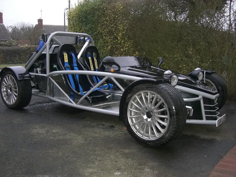

Diesel Rocket OTR... and back in the garage
Finally fully road legal , and back in garage while im away for another term at uni
a few pics from the driveway before putting away for the spring..
Had time to move the cycle wings around..

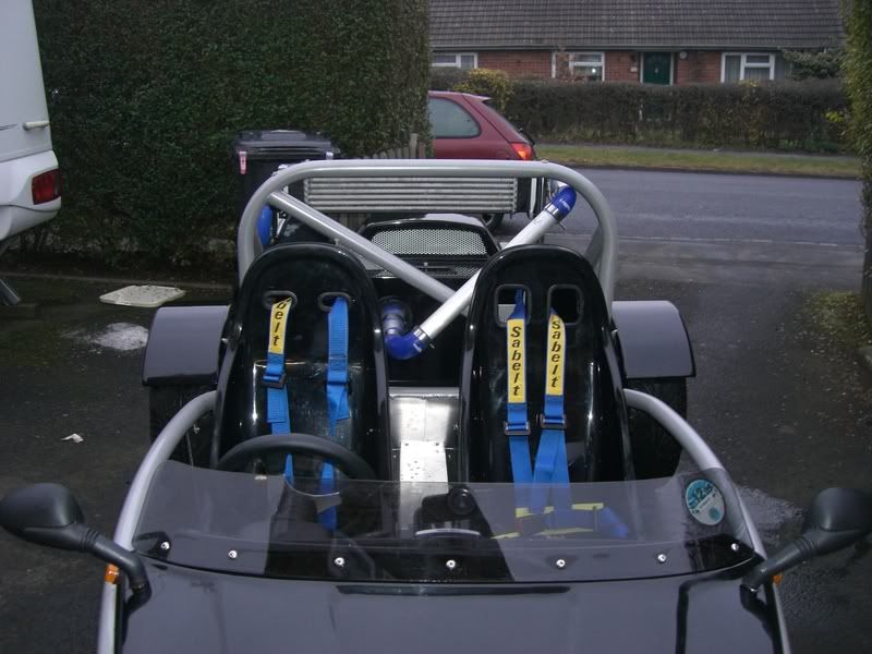

And fit the acrylic screen...

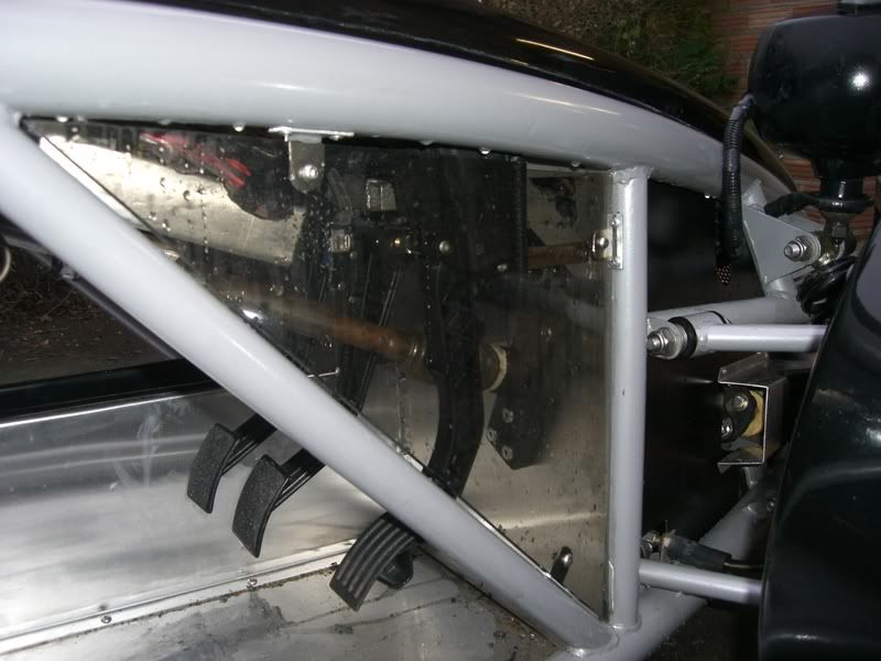

Had to fit an acrylic panel to get through sva - too many sharp edges on fly-by-wire pedal...

Veeeerry tidy! I like.... how does it perform with the diesel in it?

Love the intercooler

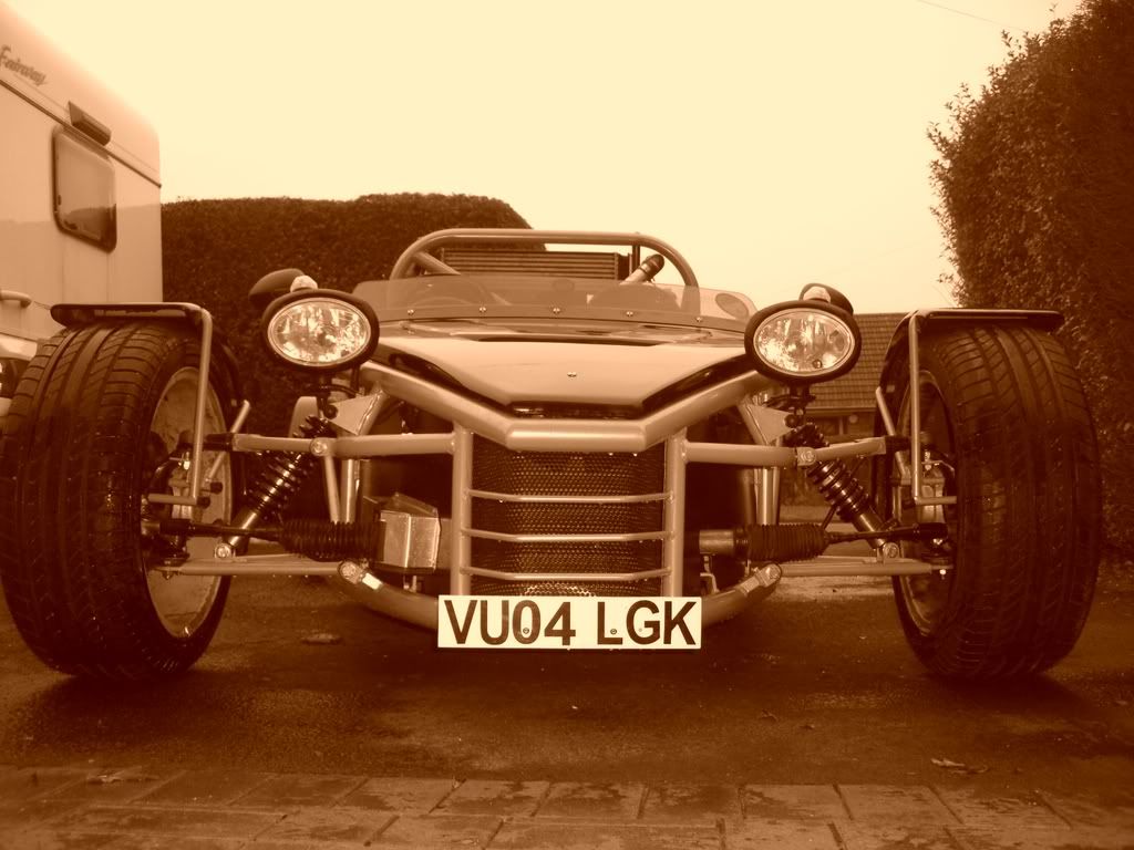

...except for that front number plate (doesn't look quite the right typeface to me, doesn't have maker's name, etc.)

yes i must admit the front number plate is homemade - all be it on a cnc sticker machine.
how does it go? like a stabbed rat keep it in the powerband (2000-4000) and its very lively. the turbo makes some interesting noises too...
ohh yea... and ive done 53 miles on less than 3.5 litres of juice
the handling seems really good to me, but my other car's a picasso.... so not much of a comparison.
technical stuff:
136hp @ 4000rpm
320Nm @ 2000rpm
approx 650kgs
3rd generation common rail injection.
running about 16 psi boost.
