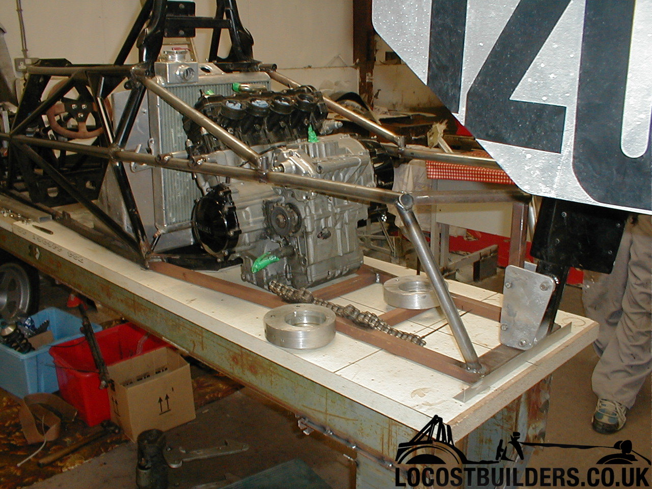

Steve Hignett
| posted on 1/2/09 at 04:59 PM |
You want to have a look here:
http://www.locostbuilders.co.uk/photos.php?action=gal&user=lsdweb&folder=swift
This is what Wyn (Lsdweb on here) did to a Swift!

Yes it’s the one of ebay, it’s a Nemesis supersport, plan is to do something like the swift mentioned figuring the chain diff route will be lighter
and easier to set up. Initially I will only be using it a track toy so won’t be bothering with reverse, so again keeps thinks simple, ditto will be
fitting very little lighting.
Motto for the build is “light, simple, fast”
