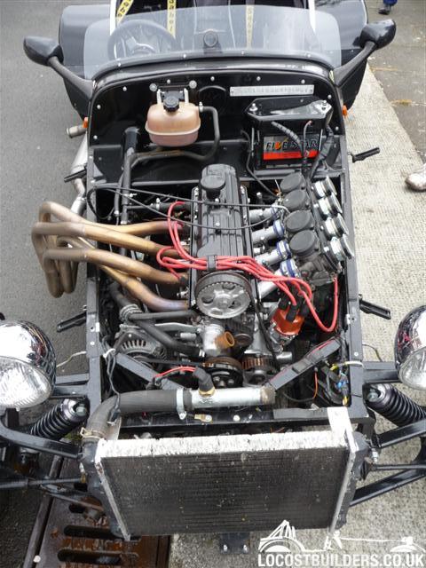

My engine has gone
My 2 litre pinto has gone to its new home
today.
I was quite sad to see it being driven
away in Neil's (yorkie's) car.
so i want to thank Neil for buying the engine and thank, Steve(coozer)
and Mike(guiness) for coming over and helping Neil and me to remove it from my MK.
It was quite amusing at times all four of us
fighting over the same bolt
The four of us had it out, mounted on a wooden frame and into Neils boot in about an hour,
Some good banter was had too.Need to get the zetec in the hole now.
Thanks lads I couldnt have done it without
you all.

it took 4 of you to take a pinto out! i did mine on my own in the garage, mind you an extra pair of hands would have been handy at times!
has he took the exhaust as well? are you aware that the zetec exhaust ports are on the opposite side to the pinto, so your exhaust will now run down
the passenger side and not the drivers side

Yes, Neil took the exhaust, inlet manifold,fuel pump and ignition system.
I bought the new zetec zorst from me mate coozer,so will be posting for ideas to fill/cover the hole in the bonnet.Any ideas?

Silver top or black top Zetec ?? if its the silvertop you may need to make some mods to the steering as it fouls the oil filter. My Locost is
4" wider than standard and still required modification to miss the oil filter

from the looks of your pictures i would say that you have a large-ish hole where the exhaust came out, is there any way that you could use that hole
as an intake for cold air to the intake for the zetec otherwise new bonnet?
