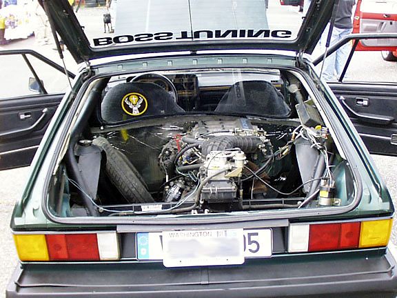

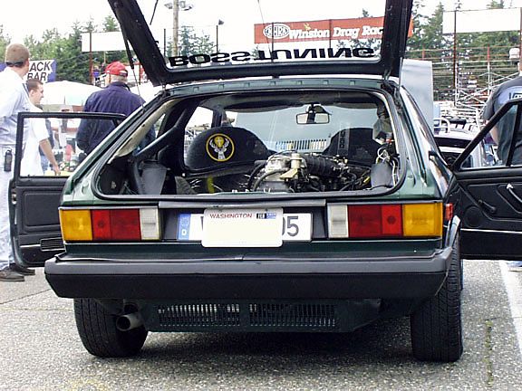

http://www.scirocco.org/photos/53/mk1reareng001.jpg
http://www.scirocco.org/photos/53/mk1reareng002.jpg
1980 scirocco w/ a 16v engine, not huge horse power, but there's any number of tuning options up to 350+hp on the standard VW i4 platform. Boss
Tuning in Portland Oregon did this one for less than 1500lbs wet.
Much the same has been done transverse mount w/ 1st, 2nd and 3rd gen golfs by dubsport in GB. I'm guessing if a person REALY tried, a 1st gen
golf could come down to 1350 to 1400 lbs and still be street safe.
