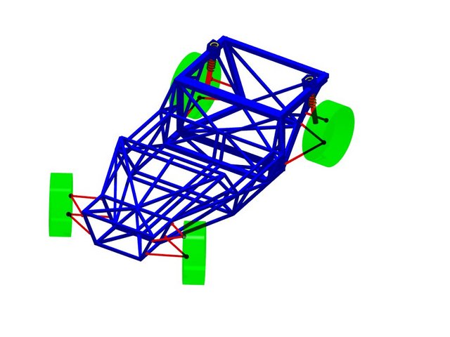

Hello.
Just found this group and I think that I might have found my home on the web.
Its good to know I’m not the only person out there as sane as I am!
Attached is picture of the plan to date, there’s a whole lot of work still to do!
One thing I thought I’d share with the world straight off the bat is a program called framework from:
http://home.wanadoo.nl/wolsink/
It’s a free linear stress analysis tool which I’ve been making a lot of use of and I’m sure saved me from producing a wobbly old piece of junk even
before I’ve started.
Doug.

Like the design, looks good, what software did you use to produce the pic?
Alex

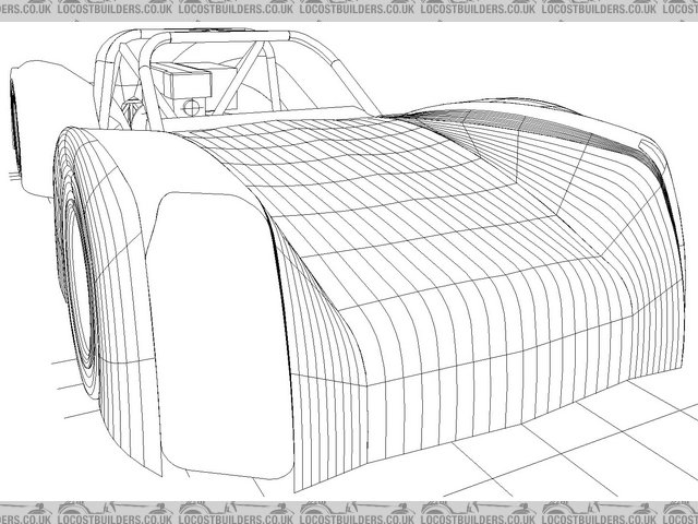

Thankfully I have access to quite a few CAE programs through work, this started off MicroStation (Similar to AutoCAD) but that was a royal pain to
control the design.
What you see here was done with Solid Edge which being a proper solid modeller is just right for the task.
At some point I’ll need to learn Blender or some such for doing the arty body stuff but that’s a way down the road. It’s always been in my mind that
the body should be a reflection of what’s going on underneath it rather than being a silly shape drawn first into which everything else then has to be
jammed.
Attached is one of the early MicroStation goes at a body, just to see if was possible to do something that didn’t look silly with the mechanicals I
had in mind.

Looks good but have you considered how your are going to accurately weld all (ten?) of those tubes to a single junction near rear of engine?
Also, how does the engine come out? Not hacking on you, just curious.
Cheers.
"Our watchword evermore shall be: The Maple Leaf Forever!"
Doug68
| posted on 26/10/06 at 06:07 AM |
The cross bracing over the engine is going to be bolted in.
The engine will drop in through there.
The gear box will already put in going through the same hole.
The top tube coming up over the gearbox will be bent so there’s actually 7 tubes
coming together which I agree will be interesting proposition to weld properly I expect some sort of fixture or plate work will be required to keep it
all aligned during the process.
