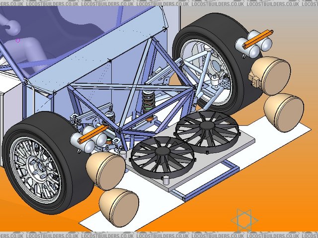

The picture shows the current plan where the air goes in under the radiator and exits through the hood ala Ferrari.
The current radiator size shown is 19" x 30"
What I want to is vertically mount the radiator in front of the forward bulkhead which will mean it'll get a size of ~12" x ~34" and
vent through the wheel arches.
The engine being cooled is a V8 Toyota which in my dreams will one day make ~400hp
Obviously from the nose to the rad will be a sealed duct.
Doug.

It is not a good idea to have a radiator at anything greater than a 30 degree angle to the airflow. Yours will be 90 degrees?

I may have misunderstood your drawing / description but if the rad is placed flat & horizontal you will have to fabricate some efficient ducting
to change the airflow direction for maximum efficiency, therefore the rad size will have to increase to compensate. If you have the rad at about 30-45
degrees the airlow will be changed BY the rad and you just need to look at the exit ducting.

You will need to install curved baffles to re-direct the airflow and from the pictures, the pinafarina car has the rad a lot higher up than your
design. I suspect the egg crate grill is part of the ducting.
I have had cooling issues with my car until I re adjusted my rad from 45 degrees to 30 degrees.
I can't remember where I read this, but it is one of those things that you will find out when you drive at speed.
My car was fine in traffic, but on motorways the temperature slowly climbed. This is because the airflow took the path of least resistance. Changing
the angle meant no more cooling issues.
The rad was even located in a enclosed duct.
