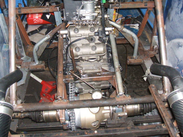

| posted on 25/1/07 at 12:34 AM |
if you dont chain drive it you will have big gearing issues , ive chain driven my kitten and it weighs 485kg with a full tank of fuel, im chuffed with
the tl motor and ive kept it on 10" wheels as i dont have the secondary reduction that you will have if you use a car diff
