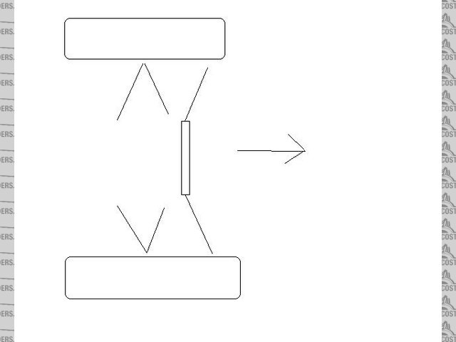

One of of things that strike me first of all I suspect you may be getting unwanted toe-in when the the steering is turned.
The steering rack needs be moved back a bit relative to the track rod end ball centres.
should look more like this
[Edited on 5/10/07 by britishtrident]

RazMan
| posted on 5/10/07 at 05:03 PM |
That's interesting, I haven't come across that suggestion before. I would be worried about introducing bump steer though and the rack
would be a real bitch to move now.
There is absolutely no bump steer with the current setup so I would imagine that any unwanted toe-in must be minimal except on full lock.
I notice there are two types of track ends. The type in the pic has a kink in it which throws the track arm forward a little (mine is central) Does
this affect anything?
