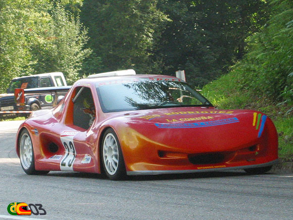

Hi Guys,
Nice posts! Learning a lot from you as usual. The Mini I posted has been designed for a specific Spanish hillclimb class called CM which uses this
type of very light car with bike power. This relatively new class is bringing very interesting affordable prototypes which I hope will start to be
available as track day cars. Conceptually they are all very similar but they come in different body shapes such as formula, full body with no top
(similar to a Radical SR-3), full body with no doors or side windows, coupe with doors, full body with a cabin (similar to a Retoga) and so on:
As for the Mini, I would expect a good dynamic behaviour from it as it's been developed from extensive racing experience and jointly with driver
Benito Varela who has been and is the quickest CM driver at the moment. He usually drives a formula but last year he raced this Mini twice and
finished first on one of the races. But the really interesting thing is that this Mini could be available for roughly half the cost of the ZCars Mini
(around £12k for a turn key). I guess this car could be made a kit. I think this would make it very attractive for UK customers (either as turn key or
kit).
