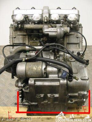

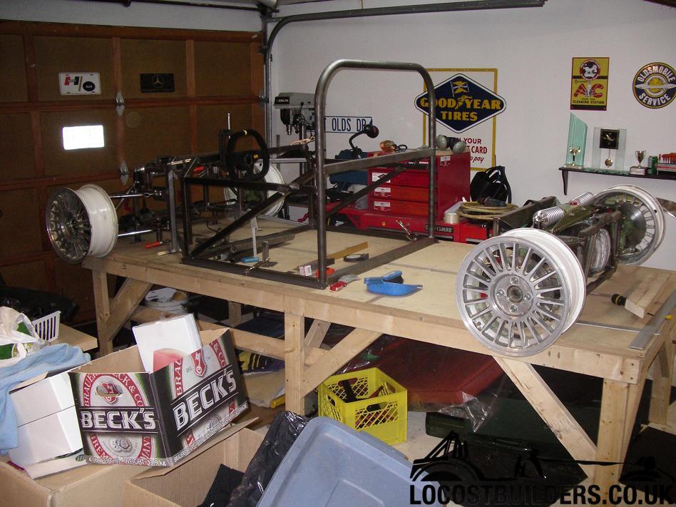

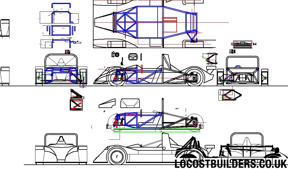

Im Considering an FZR1000/ Thunderace engine for my BEC middy. I intend on fitting an injected r1 engine, but an opportunity for a FZR1000 engine has
presented itself. Could I bother anyone with an FZR in there possession for a few dimensions. Heres what would help out and some pics of my
progress.

I've got an FZR1000 Exup in the garage, so I'll try to get those measurements for you in the morning.
Good choice of engine I think, compared to an R1 it's got loads of torque, pulls strongly (still about 150bhp when derestricted) and cheap as
chips if you blow it up!
I'm off work tomorrow, so I'll get the dimensions then - they may be a bit approximate as I have a bike around the engine - but I'll
do my best.

OK,
A- front of oil filter to gearbox selector pivot - a bit difficult to measure with the fairing on but 330 mm is the best I can do!
B- gearbox selector pivot to rear of engine - 50 mm.
C- Gearbox selector pivot to in line with top of clutch slave cylinder (as per diagram) - 115 mm.
D- gearbox selector pivot to bottom of engine - 25 mm.
Hope that helps,
James
airframefixer
| posted on 1/2/08 at 04:25 PM |
James
Thanks, thats a big help, I should have lots of room to spare. It also appears that the output sprocket is much closer to the ground than the R1.
