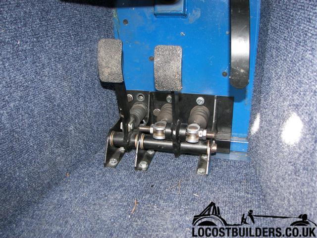

Dave Bailey
posted on 22/10/06 at 08:20 PM |
john any chance of a picture of where the pedal connects to the cylinder????
thanks

Johnmor
posted on 22/10/06 at 09:23 PM |
I will send one tomorrow.![](/images//smilies/smile.gif)
Dave Bailey
posted on 22/10/06 at 10:55 PM |
thanks!
Johnmor
posted on 23/10/06 at 01:22 PM |
Pedal box
This shows using a clevis pin above the pivot point of the clutch pedal.
This would work just as well in a velocity.![](/images//smilies/smile.gif)
tks

Dave Bailey
posted on 24/10/06 at 06:03 PM |
John......thanks for the Photo
Dave B.
