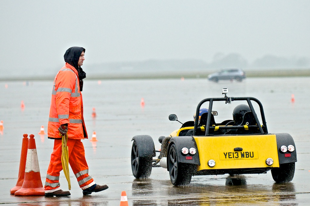

Winter mods all complete (including new rear lights) so went out for a little jaunt.
My god these things are dangerous on greasy roads.

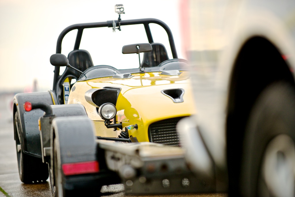

yellowcab
| posted on 11/1/14 at 05:58 PM |
Just an observation, you seem to have static positive camber in your rear wheels, which I've mentioned before but always put it down to camera
angle... but it's clear as day on this photo.
I know you're on an axel, so might be worth looking into shimming it, to give you better straight line and corner stability

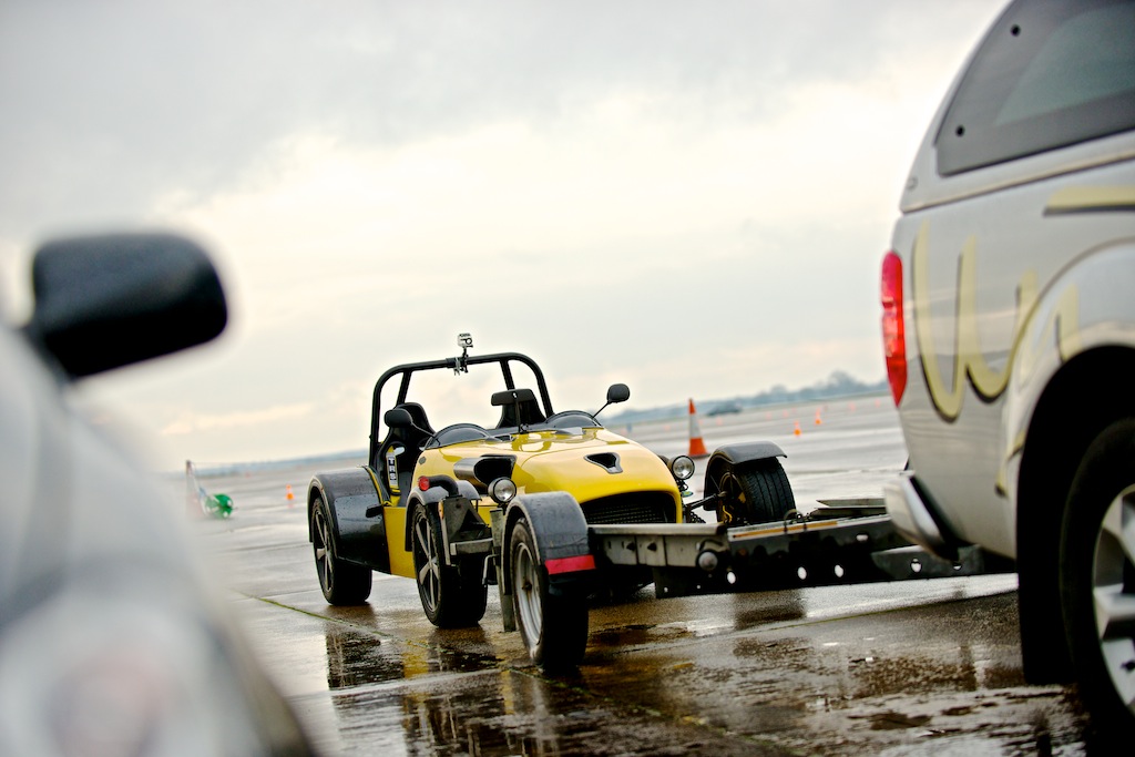

Booked a last minute trackday in my Locost this weekend at Elvington airfield. It was meant as more of a shake-down than anything as it's the
first time the car has really been driven in anger since it was completed.
There was torrential rain in the morning sessions which was, quite frankly, awful and meant I had to go to the local Asda at dinnertime to buy some
dry clothes!

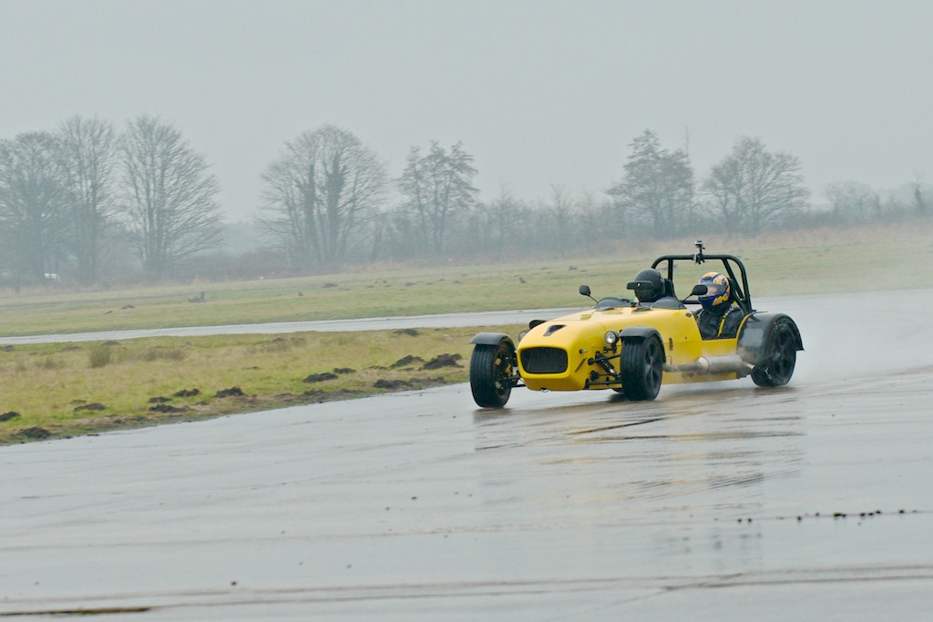

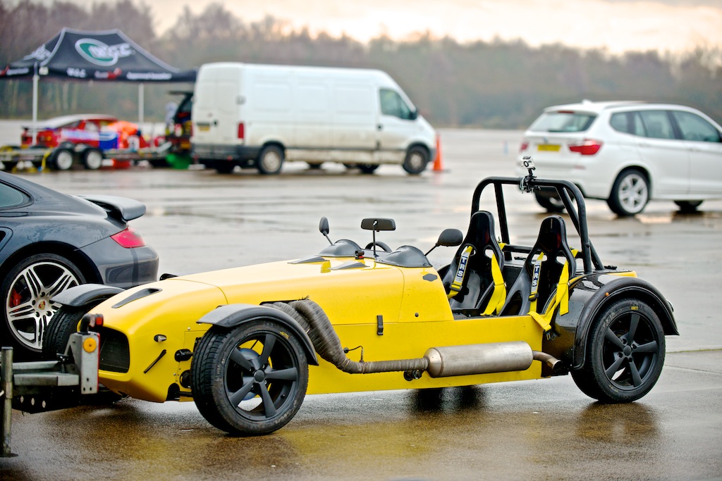

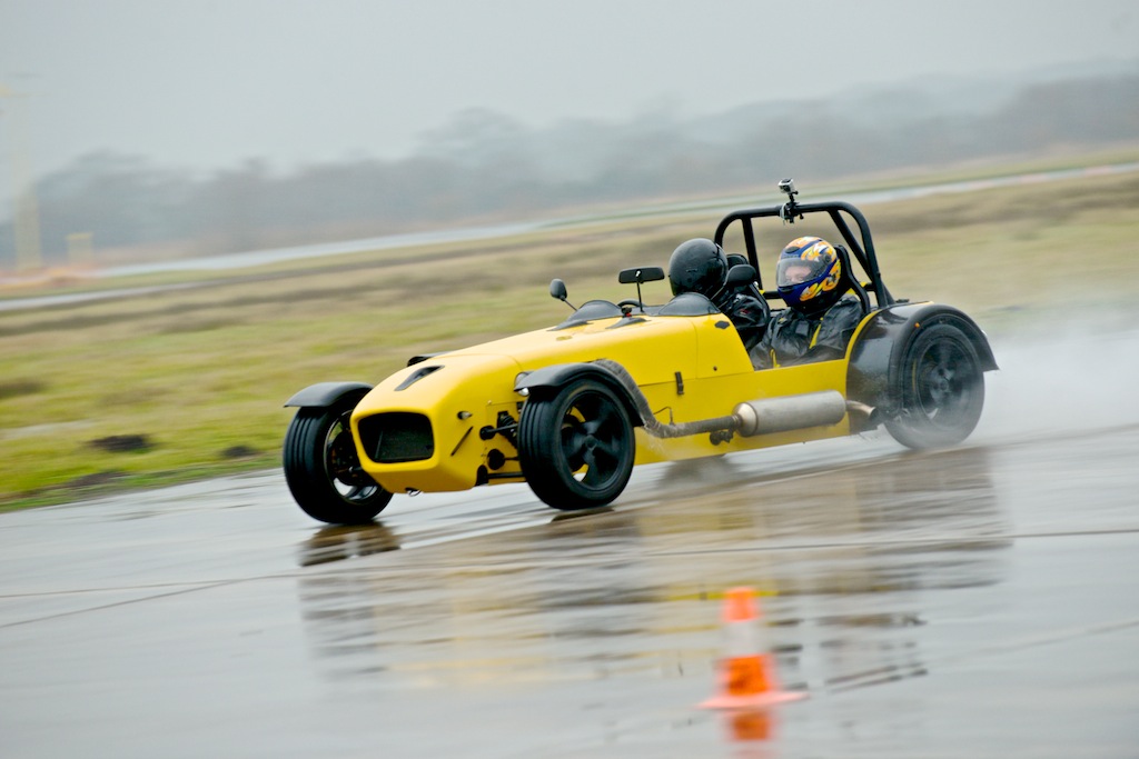

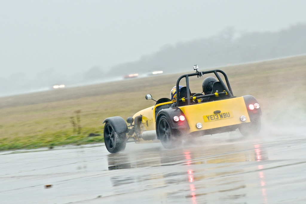

Here a few of mine that capture the essence of a rather moist day out...

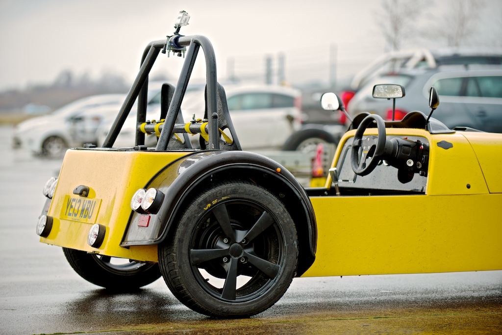

yellowcab
| posted on 23/1/14 at 09:12 PM |

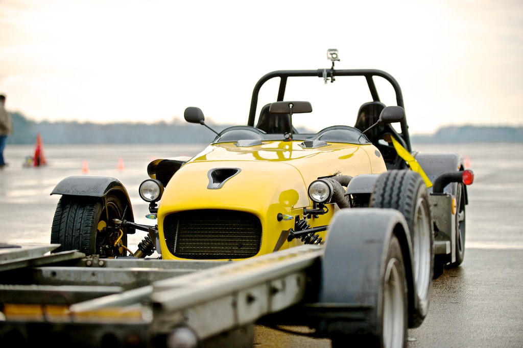

And a couple of your car in general as this is your build diary

When I booked the Elvington trackday I was made aware of the relatively low drive-by sound test. Not wanting to trip this sound meter, I created an
'induction noise' shield for my TBs.
It looks very rough and ready but did the job on the day and didn't affect performance either.
So, further Ollys very wet photos above; this was the state of the car when I arrived at Elvington:
...and this was the state of the car the following weekend
