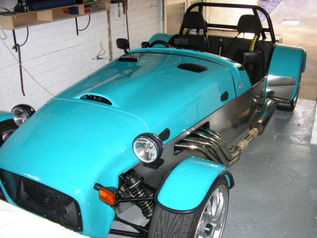

I have just got round to fitting my wheel arches (its only been just over 4 years) and it appears that i have the same size arches as this one
[img]
  Complete Car Side
[/img]
not like this one
[img]
[/img]
now i have done a few searchs regarding arch position and that the front edge has to be in front of the wheel rim, now if i do this with the arches i
have it will move the rear edge up above the centre line of the hub and look silly.
What i want to know is if i fit them as in the blue car picture will i pass sva or am i going to have to put the wheel arch forward and extend the
lower section to go past the centre line of the hub? or is the rear covering not as important as the front/top?

Front Mudguards - SVA requirement:
The top/front edge:
This must be forward of a vertical line from the frontmost part of the wheel rim (NOT the tyre).
Lower / Back edge:
This must be below a horizintal line through the axle centre.
Back wings on a Viento will be OK.
However, there are two schools of thought, and both are OK.
Either the front edge of the wing is level with the lower edge of the chassis.
Or the Back edge is level with the lower edge of the rear body.
I went for the back edge all being level.
From a sideways part / view, the front guard must cover all the tyre. Mine were a bitch, and only covered by about 0.5mm on each side.
The front guards on the Blue Viento will fail SVA. they are too far back at the top front edge.
Although this was the Luego's demonstrator, it had been rebuilt after an accident (Got a new chassis, as I saw the old one at the factory after
the rebuild)
They fittted 17" wheels at the same time.
Note: those guards on the Blue Viento are early Luego ones and a sized for 15" wheels. They will barely cover a 205 x 17" wheel and
tyre.
I speak from experience - See my nice red mudflap extensions (cut from a Comma Oil Can) in my archive which got me thru the SVA.

I have the early style ones as they are 4 and a bit years old, so i am going to have to mount them so the front edge is in front of the front edge of
the rim and extend the back edge to go below the centre line or have to buy some new ones?
They cover the tyre width just

Might be better off under IVA for this one. The proposed rules are below.
1. The vehicle must be fitted with wheel guards
2. The wheel guard must extend at least 30 degrees from the centre
of the wheel to the front ( figure 1 )
3. The wheel guard must extend at least 50 degrees from the centre
of the wheel to the rear ( figure 1 )
4. The wheel guard must cover the full breadth of the tyre throughout
the required dimensions ( figure 1 )
5. The rear of the wheel guard must not terminate above a horizontal
plane of 150mm above the wheel centre. See note 1 ( figure 1 )
That's if I have read them right.

Sorry Geoff there are three schools of thought, I have mounted mine so that they are level at the Front AND Rear. This means that they sit lower down
on the rear arch and a filler section of ally has been fitted to tidy up the to edge.

At the Newark show last year there was a line up of Viento's , it seemed as if no two cars had the rear arches fitted the same. When I fitted my
locost arches I measured from the center of the wheel and mounted the arch so there was an even gap between the tyre and arch. IMHO that looks so much
better than an uneven gap .

I had (have) the same arches and had made up 'mudflaps' from some carbon look ABS to cover the front and rear angles on this. This however
was not the problem. Mine failed because no part of the wheel or tyre can protrude beyond a line drawn straight down from the edges of the guard to
the ground on the outside and inside. I dialled out all the camber and bought bigger wings to get mine through. I have heard of cars passing with
something like door or bootlid sealing strip applied round the outside edge to effectively make the wings bigger.
The tester measured mine with a spirit level by holding it against the edge of the wing ensuring it was perpendicular and checking that the wheel and
tyre could not be contacted.
I think that you will struggle to get the small wings SVA friendly and if I were doing it again I would have fitted bigger wings and not having to
mess with the wing stays and re-drilling stuff later.
