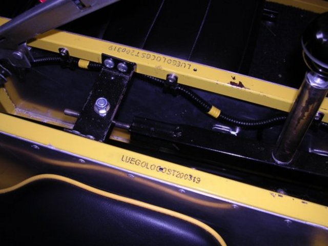

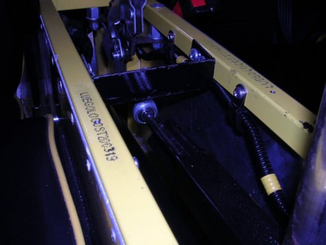

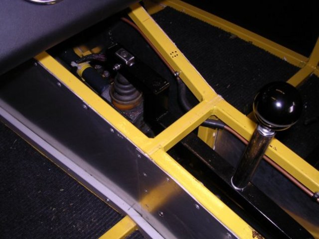

Here's my gear lever extension (design by Ben Copeland). Been in use for nearly 4 years and no problems and always works very well. A bit
agricultural but easy to make with basic tools.
I'd forgotten about that lol await to see your picture!

ashg
| posted on 8/2/10 at 02:10 PM |
  Extension
  Extension
  Extension
  Extension
is that it?

Boggle the one you made looked ok why didnt it work?
perhaps a little refinement/modification and it would work.
not wishing to upset anyone but from the pics of the one on the yellow chassis i wouldnt do it like that as the extension is chassis mounted not g/box
mounted and i can see it causing problems

wicket
| posted on 8/2/10 at 03:59 PM |
That's the one. It's an age thing!!!!!
wicket
| posted on 8/2/10 at 05:25 PM |
As I said before been used for nearly 4 years now and no problems what so ever. The rear end of the change lever is supported in a rod end which
allows for gearbox movement.

Boggle have a look at David Jenkins site as already suggested , it shows how to create a quickshift from the standard gearlever that also moves the
pivot point up the gearlever . That will then engage the fork with the selector shaft.It will also show how to fit the reverse gear stop.
Ashg , that remote is for the older 4 speed box not the type 9.

if your talking about the yellow chassis one of wickets, it works fine with push down as it was my original design. Works brilliantly with push down
reverse.
