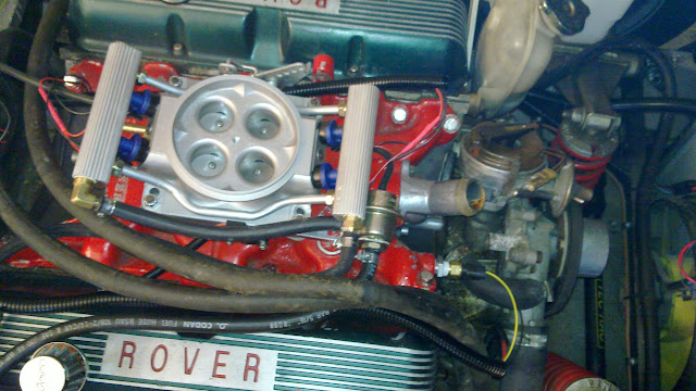

This is an early picture of what I'm doing. The injectors are in the 4 barrel unit above the Offy 360 inlet manifold, so if the death of one
was causing a misfire, it wouldn't be as regular (I assume). I suspect either a coil in my coilpacks which would take out two sparks, or just
my inability to buy leads the right length as they are very tight and may not be properly seated on the plugs. I'm going to move my coil packs
to relieve the tension.
It is a bog standard 3.5 V8 from a 1984 SD1.
