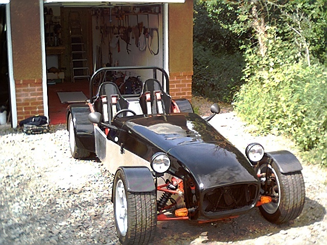

billy
posted on 27/5/04 at 09:27 PM |
locost
i think that if you dont need the extra hight stick with the locost as i have, it stays closer to the lotus 7 looks. cheers
luego-lo-cost finished,vauxhall 16v 2.0,twin 45s de-dion rear set up
billy
posted on 27/5/04 at 09:28 PM |
look
heres a pic
Findlay234
posted on 28/5/04 at 02:39 PM |
billy, youve used the luego body mostly but the velocity front cycle wings right?
