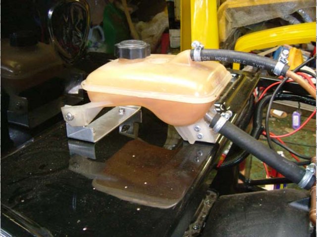

wicket
| posted on 23/11/04 at 09:46 PM |
This one Geoff ?
GeoffT
| posted on 23/11/04 at 09:58 PM |
No, the one I used was a much rounder shape, and was originally mounted against a vertical bulkhead, the one shown in your photo looks like it was
probably fitted over an inner wing panel. Will post a photo in my archive shortly - if I can remember how to do it....
Photo now in archive.
[Edited on 23/11/04 by G.Tyler]

wicket
| posted on 28/11/04 at 11:18 AM |
Tom
It came from the scrappy, marked Rover 200/400. It was a bit dirty but hot water and vinegar, let it stand for awhile, added a table spoon of brown
rice and gave it a damn good shaking, cleaned it up a treat. Left the support long to make it the high point in the system.
