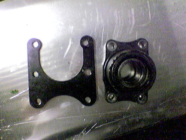

you can get a bracket thing that sits behing each hub carrier, or alternatively, i have a couple of ones from a 2l sierra that i havent used, as i
ussed the bracket things instead.
heres a pic of the bracket thing.
hope this is what your looking for.
prob got the wrong end of the stick though
tom

ta is that the caliper and mounting bracket and hub carrier of the sierra havn,t stripped mine to have a look yet need to get the hub nut,s undone and
at the minute i don,t want to buy the luego rear hub carriers if i can use the one,s i have
tom_loughlin
| posted on 26/11/04 at 05:55 PM |
yeah, the item on the felt is the bracket for mounting the callipper (darren from GTS supplied it) and the thing on the right is the standard hub
bearing off a 1.8 sierra.
i couldnt get my callippers to line up with the brake disc using the standard 2L sierra brackets for some reason, so decided to use darrens
bracket.
