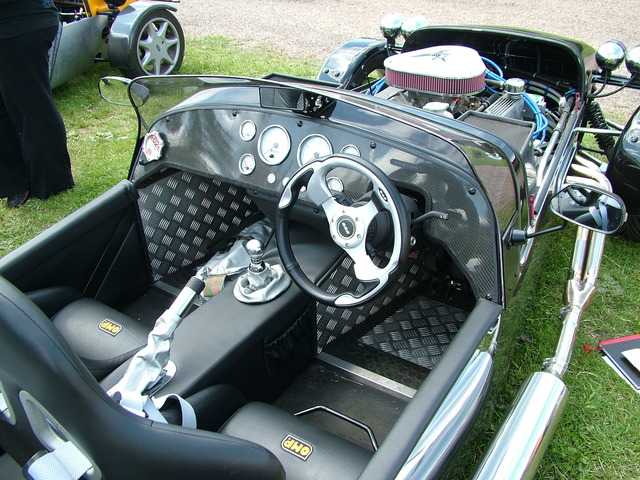

| posted on 9/7/21 at 09:59 AM |
Back when I was building my car I asked Bec and her Dad about the aero screen. They built a form the shape of the curve of the screen. Then they
turned on every heater they had in the garage and draped the acrylic over the former. With a combination of heat guns and patience they formed the
acrylic over the former to create the curved acrylic.
Theirs is the best solution I have ever seen on any kit car that was completely home built. A lovely car all round though. I hope they don't
mind me posting these images.
| posted on 9/7/21 at 10:37 AM |
http://www.locostbuilders.co.uk/photos.php?action=showphoto&photo=XA0M2462_1%5B1%5D.jpg
Another picture, just remember their user name on here, it’s perci
