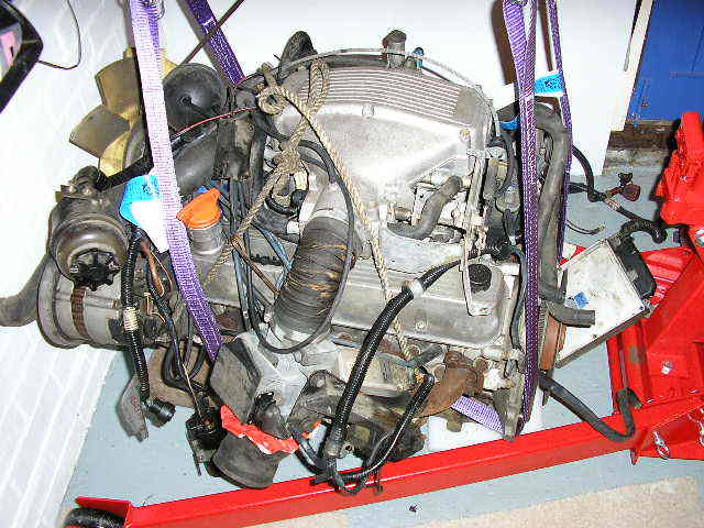

Spent the last hour looking at the rover 3.5 v8 lump in the back of the garage.
Where to Start !!!!!
Any ideads or advice on stripping the engine and rebuilding.
What Cam would people recomend....
How hard is it to hone and replace piston rings???
Is it a good idea to replace the fuel injection with a wedder 4 barrel Carb kit..

Looks like you've got a pretty decent engine there - Vitesse V8, 190Hp, loads of torque.
Nearly 20 years ago I installed one of these in my TR7. Mine was kept standard and as a result was better than many cheaply modified V8s. By better, I
mean it idled well and had a broad spread of power.
I ran mine first on carbs to get the thing going, then I put the fuel injection in - this was much better.
So, If I were you, I'd keep the engine standard and keep the fuel injection.

I kow it is an obvious question but how sure are you that the engine needs rebuilding any way ? from the photo it looks like anice clean unit modern
engines have a very long service life , especially a big lazy V8 have you heard or seen it running ? . I would do a compression check look at oil
condition ect and if it comes up ok on that leave well enough alone and use it as it is ( and retain the Fuel injection it will run better , more
efficiently any way ) Just a thought It is to easy to look for a ROLLS ROYCE solution to a ford (or rover) problem remember that any kit car is going
to weigh bugger all compared to the donor and even a tiered V8 is going to be a beast
