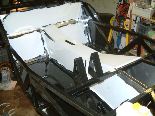

coovey
| posted on 22/3/05 at 06:36 PM |
I have poted a couple of pics. Hope they are some use.
Or have a look at my build diary www.velocityxt.co.uk there are a lot more pics on it that might help
coovey
| posted on 22/3/05 at 06:37 PM |
and this one

I have had trouble with my panel and have just had it re made by luego. My problem was that the cut out's for the roll bar stays were in the
wrong place by about 20mm or so.
We took it back to stafford show and compared it with the demo car which it fitted. Looks like our stays have been weldied in a different position to
their demo car.
In fairness to Luego i gave it them back on Sunday and i had a remade one on the thursday after which fits perfectly now. I have some pics of the old
one and can take some of the new one if thats any good.
Phill
