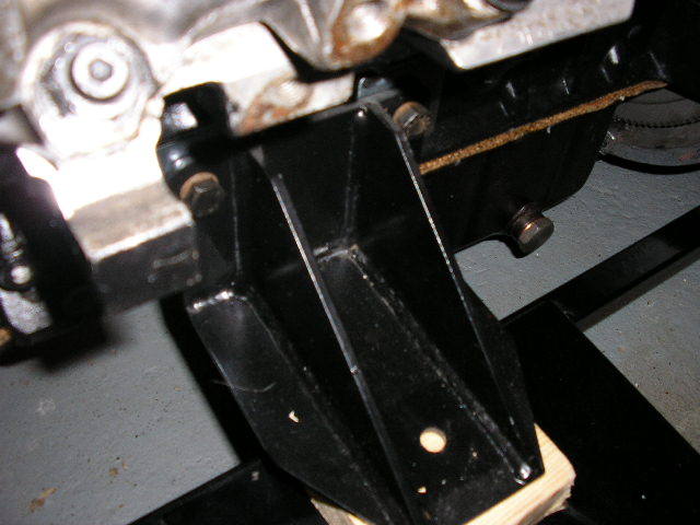

Paul (Notts)
| posted on 27/10/06 at 05:17 PM |
5mm thick

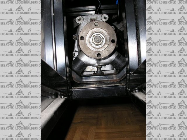

Paul (Notts)
| posted on 27/10/06 at 05:22 PM |
just need to learn to weld and buy a welder so that I can weld in the gear box bracket - or I could just bolt it in?
Agriv8
| posted on 27/10/06 at 05:53 PM |
Paul,
What it the gear box cross member sat on ? cant really see on the picture.
will take some pictures of mine and post after tea.
regards
Iain

DanP
| posted on 27/10/06 at 06:43 PM |
Looking good, what did you do about the g'box remote in the end?
I've just bolted thru my gbox mount onto the plate below.
[Edited on 27/10/06 by DanP]

Agriv8
| posted on 27/10/06 at 07:36 PM |
Paul mine is Just bolted tough some rubber mat to 5mm plate.
  Gearbox mount
oh and one with the new one in
  new engine in
Just got to get the bugger fired up Master Cylander and rad to plumb back in.
