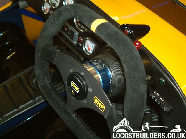

Can't you just buy a steering wheel spacer to bolt in between your hub and steering wheel, maybe even a quick release one to aid entry and exit.
I fitted one like this

| posted on 24/7/07 at 08:52 PM |
Could do but I need to move the steering wheel poss upto 4-5 inches, and indicators etc would be unreachable if a larger boss was fitted.
