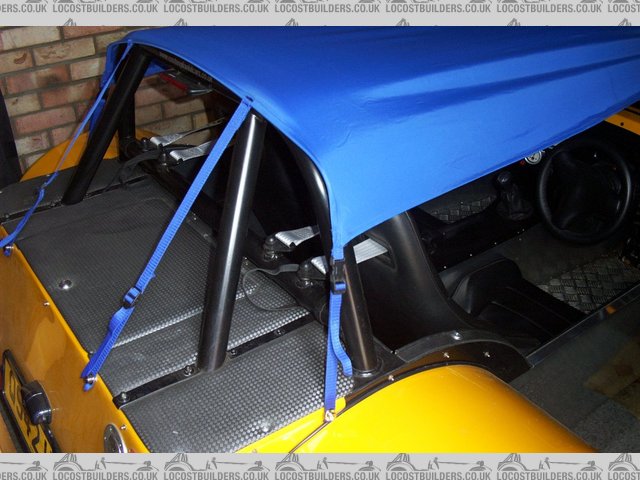

Hi. Piddy here.
company I brought the fabric from
link to the fabric used

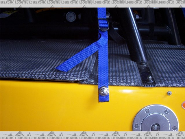

I made the top as a temporary item until I had a full roof made and have stuck with it since because it works so well and is small to pack away.
I cut the material to size and then stitched a channel in both the front and rear. The front contains a length of TV coaxial cable to give a tight
fit in the awning rail.
The rear channel contains a length of steel rod (6mm think). The straps have a loop stitched in the end of them to enable the rod to fit through them.
The side straps are stitched direct to the Surrey material.
Where the items are stitched I have stitched them in an oblong and then corner to corner using a good strong Nylon thread.
The roof has been tested up to 90 MPH both wet and dry.
The awning rail can be purchased from any large caravan camping store.
I hope this helps and hope to meet you at one of the shows in the future.

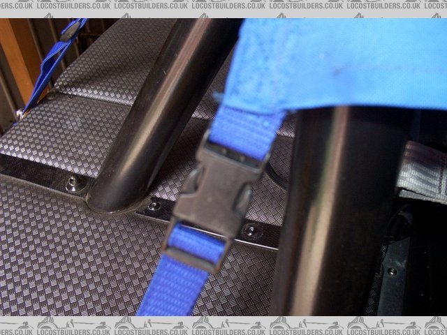

| posted on 26/6/08 at 05:42 PM |
I should have said you can also get the plastic buckles and adjusters from the same comapny.

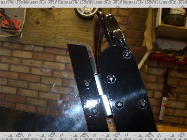

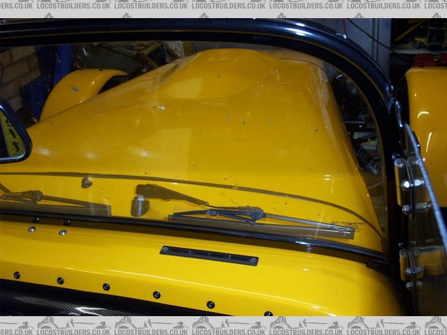

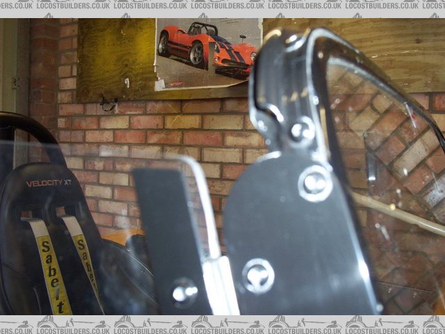

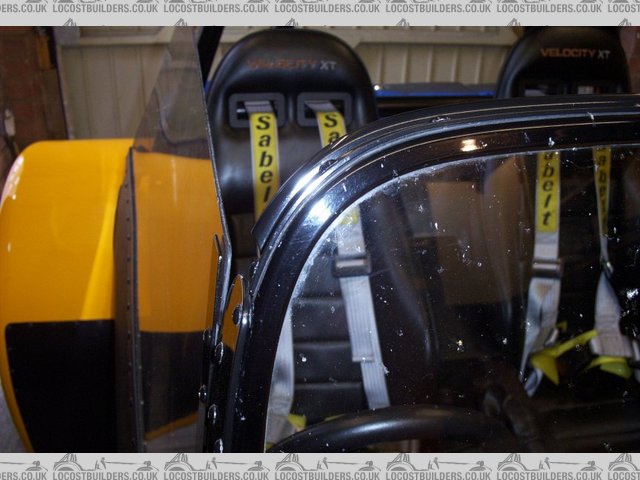

Pictures of awning rail as requested

and another

and another

last one
Steve Lovelock
| posted on 18/7/08 at 10:04 AM |
Thank you very much
