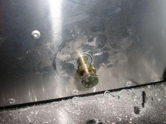

The following 3 pics show the bracket drilled on the wheel side , The fitting from the inside and the bracket on the transmission tunnel side ( note
the large square washer between the ally and the bracket to space the fitting out)
If you are still unsure I can probably find other pics.

stuiesav
| posted on 19/8/08 at 06:58 AM |
Paul - you are a star - thanks so much - massively helpful!
